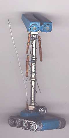

"Found" parts - Always keep your eyes open for interesting shapes and "gadgets" to add realism and variety to your customs. Computer parts, plastic rings from drink bottles and nearly anything may be just the perfect addition to your ship, vehicle or droid. I've used "found" items such as the inside workings of computer mice, thumbtacks, metal tubing, springs and screws in some of my customs.
For example, I made this custom Treadwell droid a few years back before Hasbro packaged him with Aunt Beru. He was made from metal tubing, toothpicks, two thumbtacks (the "eyes"), a screw wrapped with a rubber ring (at the base). Wire and sculpey make up the rest of this droid. I used the plastic ring from a fruit drink bottle to imprint the treads in the base, and a gear from an old watch to imprint the wheels in the sculpey.
