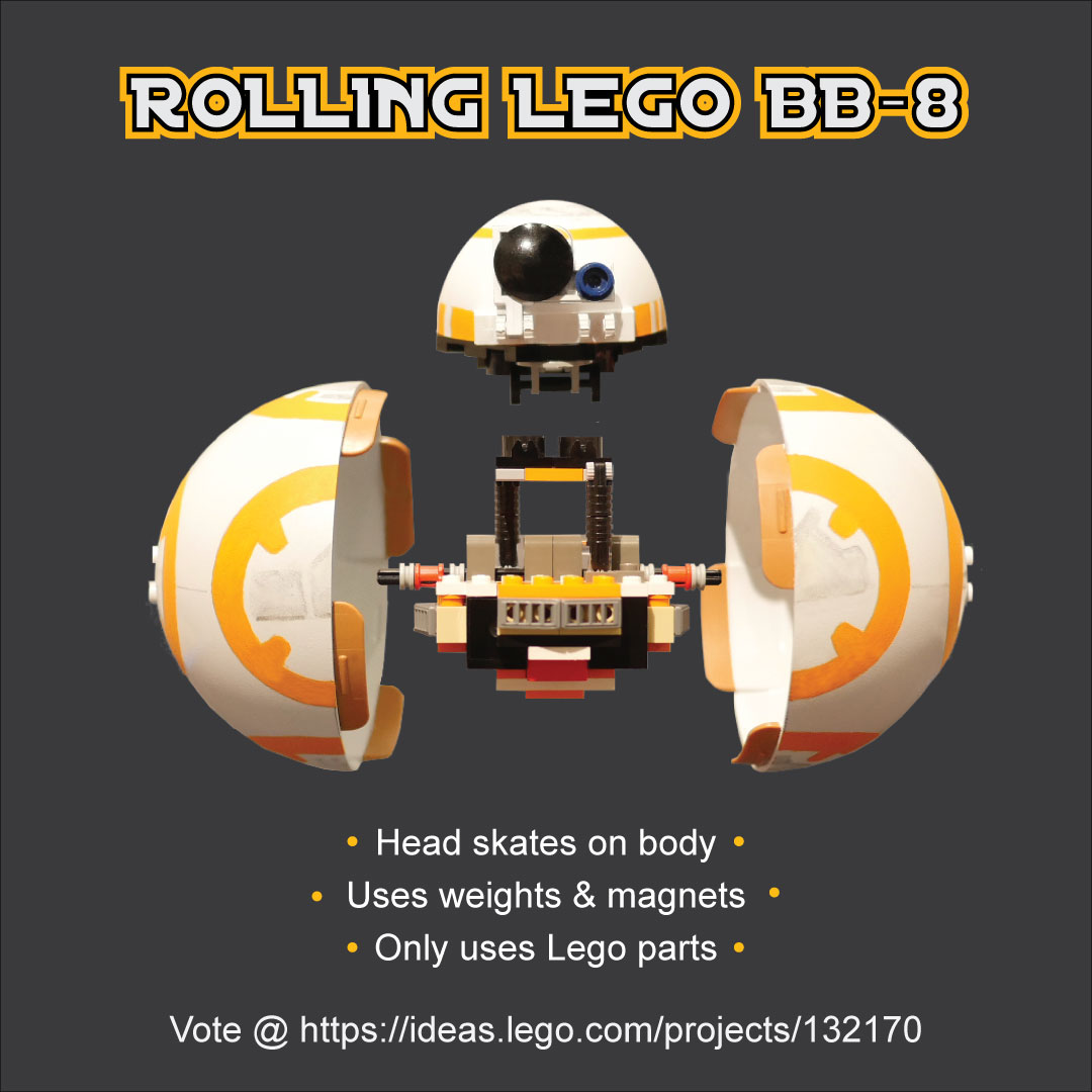

Lots of experimenting, lots of fidgeting, lots of trying everything from two, three, four different angles. This BB-8 was a challenge. The initial goal was to make it omni-directional... something we are still working on using two approaches. Approach one is a passive 3 axis gimbal made of joints and swivels that would still hang from the two holes in the hemisphere halves of the body. The other is to use rollers that would be weighed down and sit on the bottom of the sphere and hold up the magnets. The only rollers LEGO makes use breaker marble sized metal ball bearings, and even though they help with the weight, they have a lot of inertia and friction that resists sprightly movement.
While omni-direction is still in the works, we resorted to a single axis to get the ball rolling. It may seem simple, but it is still a struggle to find the right balance between weight, magnetic strength, and size. The heavier the head, the more magnetic strength we need to keep it attached, but more magnets strength creates more friction on the wheels which can result in the head holding the weight up, rather than the other way around. The more weight that goes into the head, the more weight we need in the base, but space is limited. Because of this, the first design goal was to find the maximum weight we could cram into the lower half of the body. Turns out to be 3 LEGO boat weights and various bricks to fill in all the empty spaces. After that, the issue was designing a head. We considered brick built, but even the simplest designs weighed too much. We ordered one of every different dome shaped piece LEGO has ever made off the net for hands on experimenting. We have several different head prototypes, and could easily get most our design goals in if we used glue and modified some parts, but with the aim of going pure LEGO, we landed on the head design shown on our projects page. We are still working to find a way to reduce the head's height from off the body. We would love to have an antenna on the head, but with no dome parts having studs on top, its going to have to weight on the back burner.
